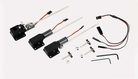

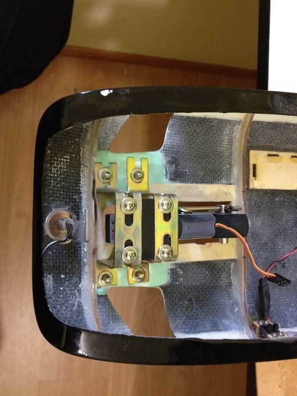

Well mates, after a lot of time I started to work with the bird again, the heli is beautiful but I never could make the retracts that came with the fuselage to work properly and I decided to change the retracts for the 15-25 eflite tricycle retracts
Adapt the eflite retracts to the airwolf fuselage took a lot of work, first I had to take out the old system

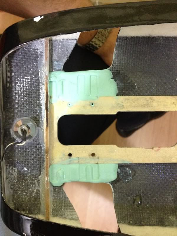

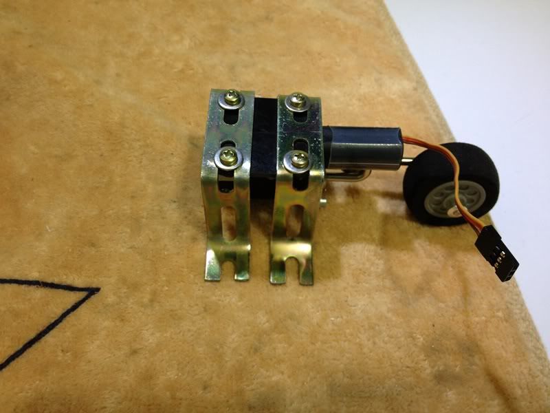

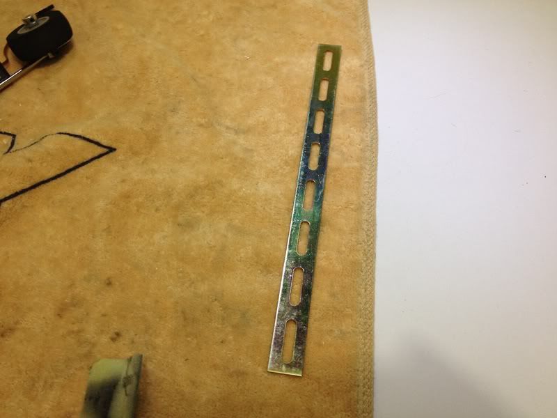

Then I had to figure out how could I adapt the new retracts, the front one was the most difficult, I used this piece, don't know the name in english
To do this

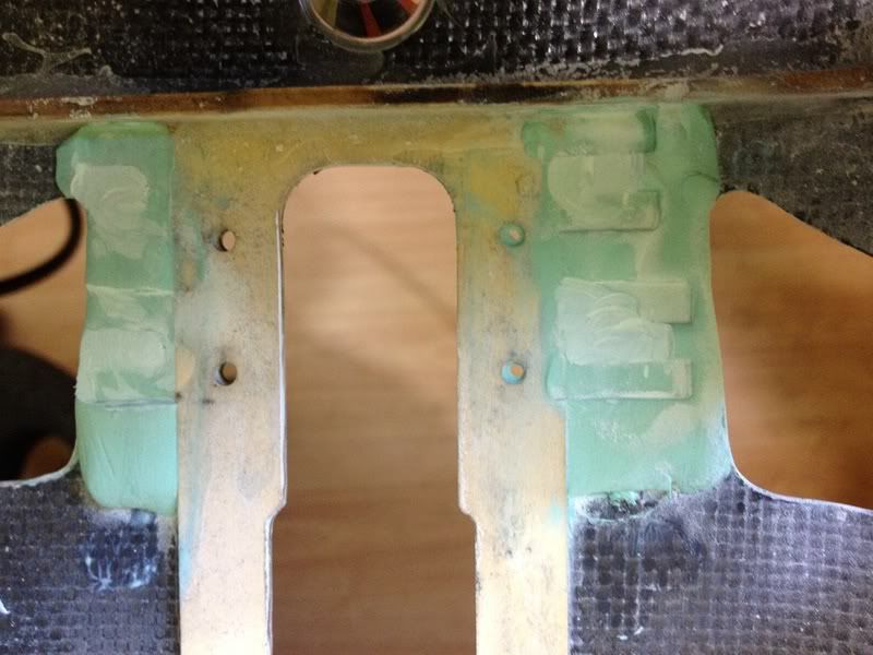

And with epoxy putty I prepared the fuselage to receive the front retract

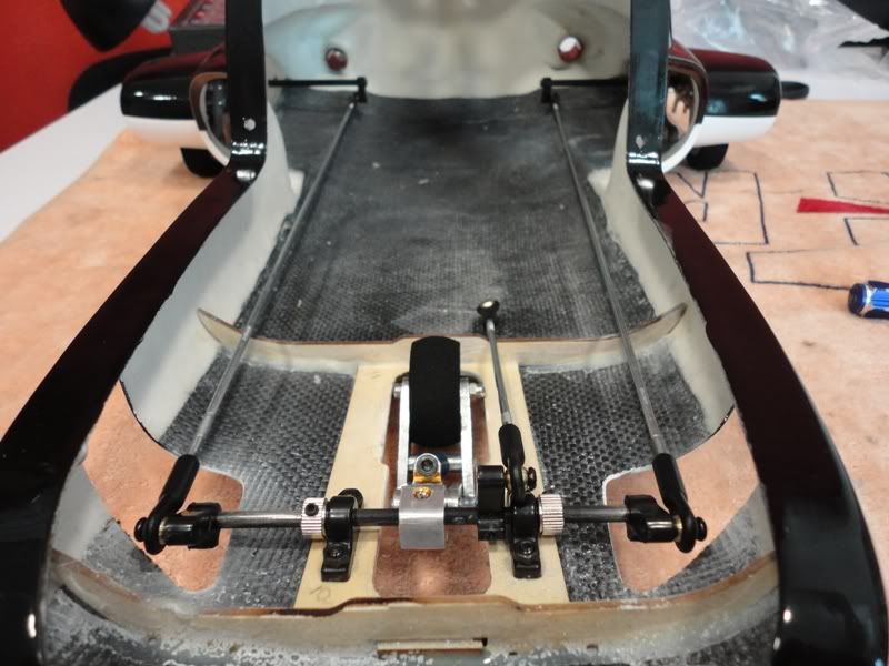

And the result was this
Have to do something, I'll continue with the post latter  :130:

Now the rear retracts, after a lot of thinking on how could I instal the rear retracts, I came out with this solution
This is the place for the retract
This are the retracts that I had to install.
I used this piece of wood to make a base in which I could install the retract
And this is the result.
In the video I show how the retracts are working
This is how the fuselage looks with the new retracts.
The next step will be to assembly the heli again, will fly her to see if everything is working properly and then I will paint the imperfections  :130:
